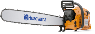

Bah, you guys are creating too much work!
Just line it up really good and cut right down the center seam on the bandsaw. You can always glue it back together later.
CVT Inc.
PostPosted: Thu Sep 15, 2005 6:13 pm
Your a gas Jason. Got to get up to see ya soon and try that new Husqvarna grinder of yours.
Or your new thickness sander
Rod True38611.1392476852
PostPosted: Fri Sep 16, 2005 1:12 am
Posts: 574
State: BC
I have both of those items pictured
Your gonna have to come up and visit soon, we're in the process of running so much cedar it's silly.
CVT Inc.
